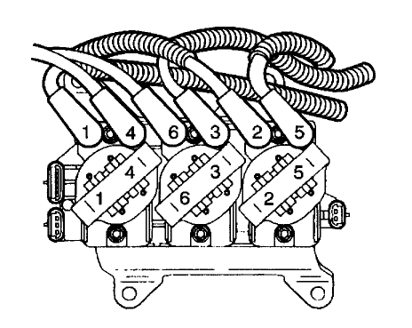

- Label and Remove all plug wires from the coils (firing order can be found below for the 3800 and the 60° V6)

2.8, 3.1 & 3.4 Firing Order
3100 & 3400 Firing Order
3800 Firing Order
Coil Packs
